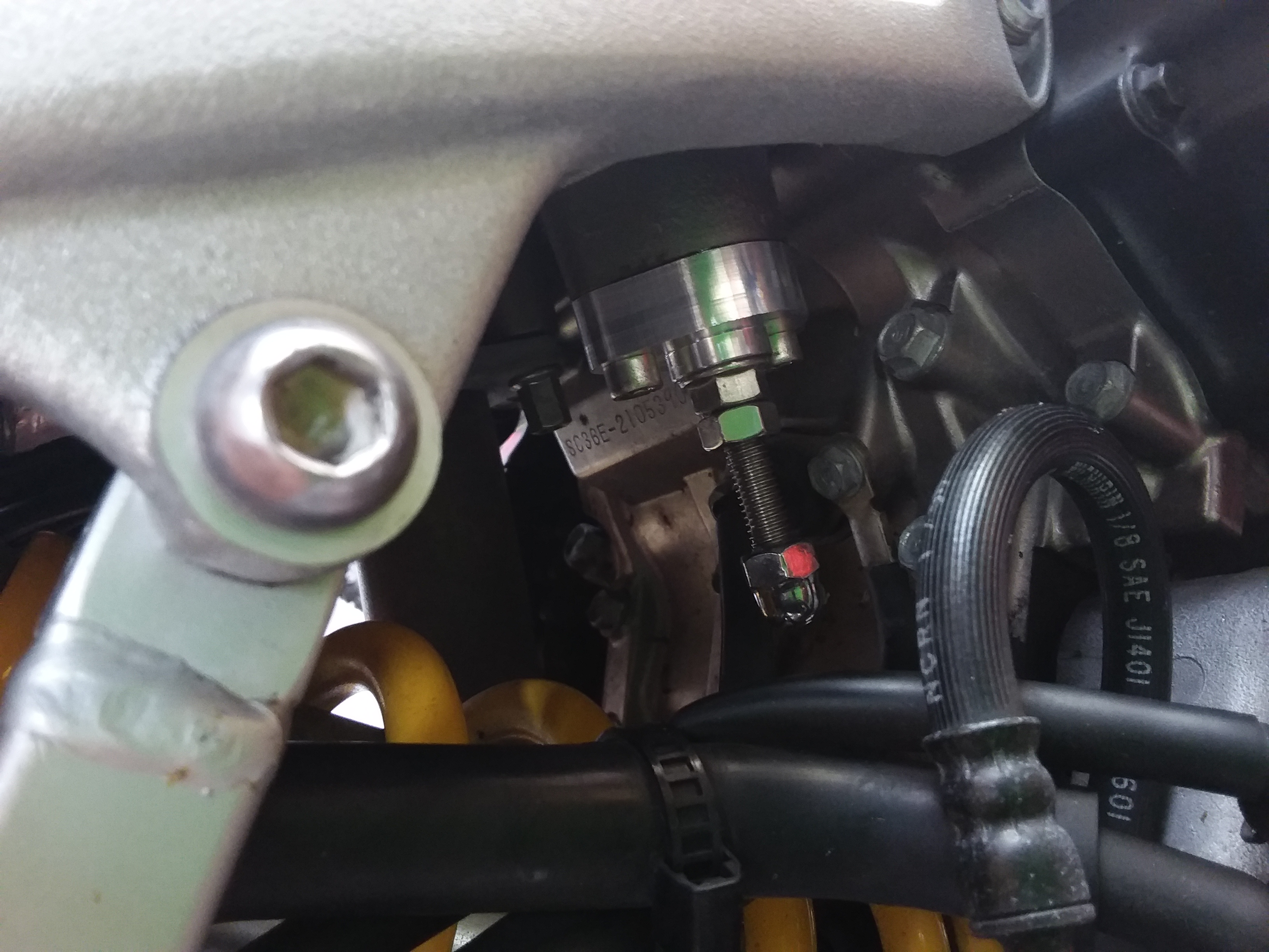

Worked my way through the guide and got to the cup of tea stage, finally got the cap off. Only hiccup was taking the wrong 8mm bolts out of the oil cooler bracket. Soon realised Image
Sent from my SM-G930F using Tapatalk
