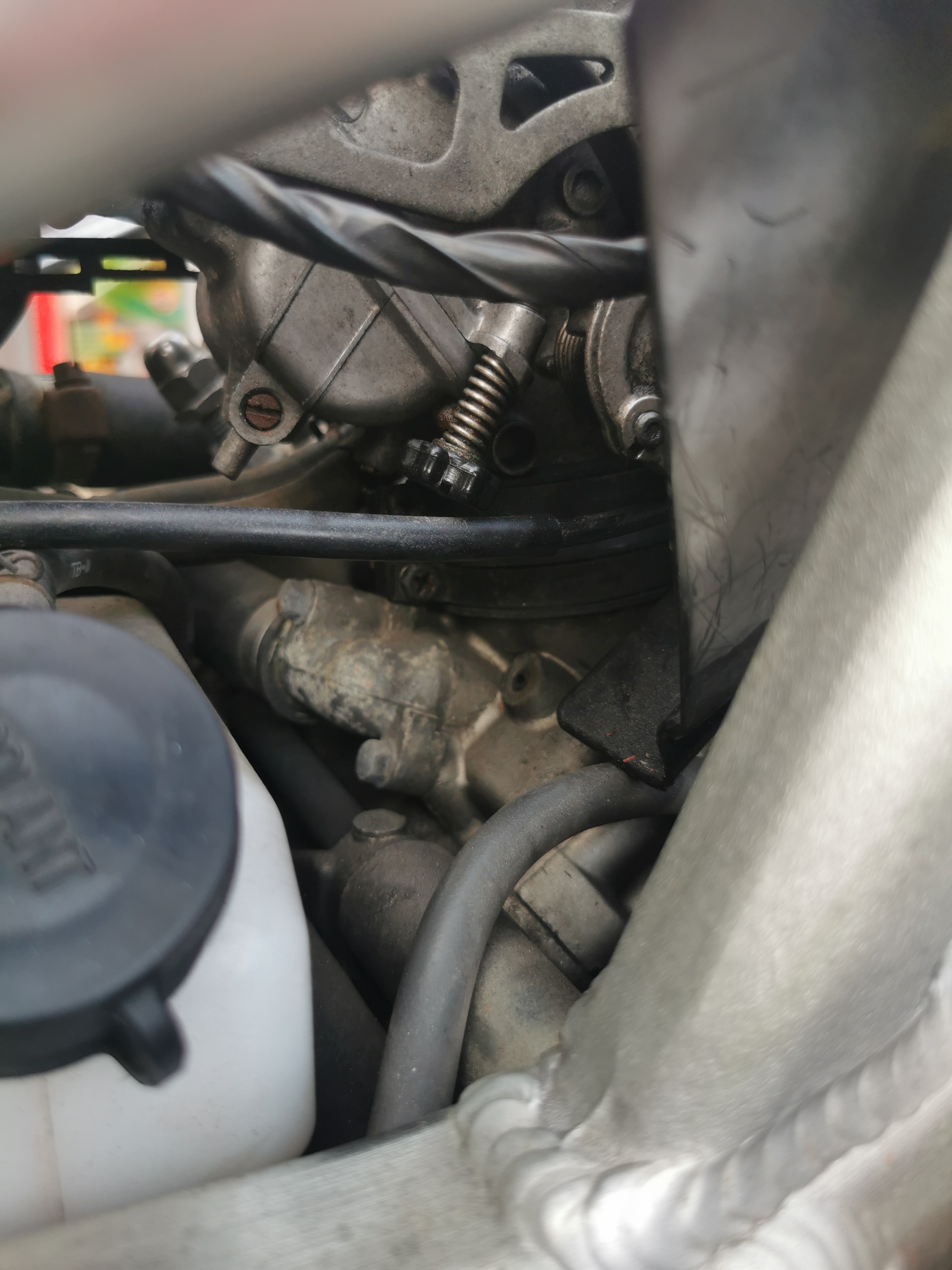

Hi everyone, I,m a newbie to the site & have only recently purchased a 2002 firestorm. I have just fitted a stage 1 kit & decided to balance the carbs.I understand where the front take off point is but I am unsure about the rear. There is a picture where some one is pointing to the adjusting screw, just behind is a short rubber pipe. Can I detach this pipe at the left end & attach my balance pipe to it ? Will this work ?

The picture you refer to is the ajuster on the carbs, this is what you need to adjust to balance the carbs...
The top pic in thats sequence of pics shows the front take off point...
If you look at your bike from the right hand side, into the frame at the back of the front cylinder, thats where the front take off is to be found...
The black knurled knob you can see is the tick over adjuster...
As std the bike will not have a pipe there, thats what you have to fit to do the balance. As std there will be a allen head bolt which you need to remove & fit a brass take off spigot...Fit the pipe to that & thats the front take off sorted...
On the rear you need to be on the left hand side of the bike & now your looking at the front of the rear cylinder, this should already have a vac tube fitted as thats what runs to the petcock, this is what you need to cut & put a T-peice into with an extra lenght of tube on...
Then your balancer tubes fit into the extra pipe from the T & onto the tube from the front take off...
The adjuster with the finger pointing at it in the pic is what you adjust to get the carbs balanced... Top tip spray that with a good shot of WD-40, GT85 or whatever as it has a tendancey to seize up...
