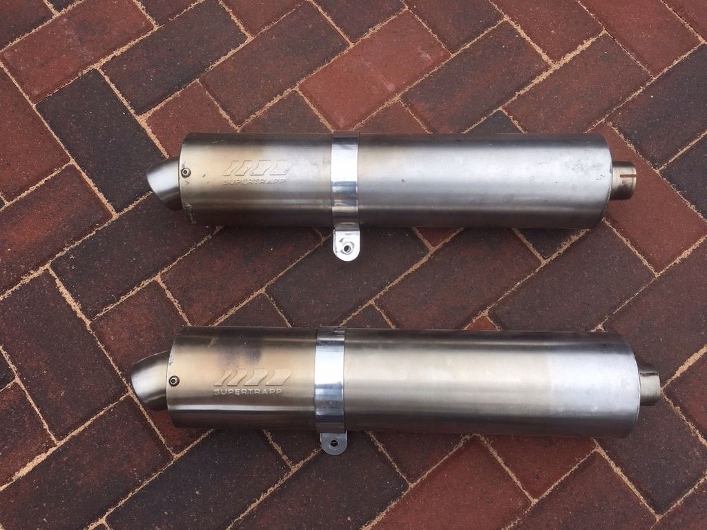

I've just spent my months £50 on these, I know they aren't megaphones, but they'll have to do.
It's going to be a long 4 weeks..
All I have to do is remove the snapped studs & build some headers :thumbup:

oooh nice cans..supertrapp make some good gear. :thumbup:
