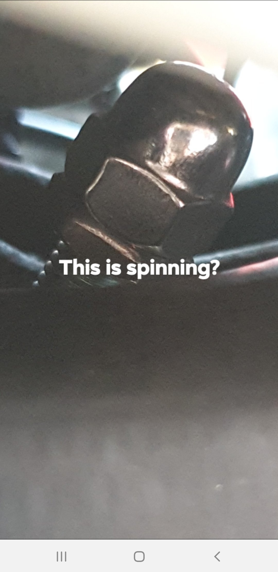

Well, after a PM from MG Mac. I thought it wise to check on my MCCT's. Good thing i did. The top one was moving. 🙈
I re-tightened in situ, and checked the lower which was ok. Bike seems to start and run fine.
See vid links to youtube i uploaded.
Vid 1
Vid 2

Make certain the locknut is doing its job - and maybe apply some loctite as well!

Yes Ade's MCCts...Personaly I thought they were a pain to fit with the lock nut against the dome & a Nylock against the body... As the Nylock took some effort to turn it was turning the bolt, despite holding the dome as the bloody lock nut was comeing loose...
If I ever have to fit another set I think I'll junk the dome & just use a plain nut & lock up to that...
Needs a roll pin in it...dont have that issue with Bazza MCCT's...

I agree, the acorn / jam nut is a pain, as the two "hex's" do not line up so you can only get a tool on one or the other hex.
If you want:
The adjuster nut (acorn and jam nut for it) is just for adjustment, meaning it needs to simply be retained against vibration.. your not putting but a few inch lbs of tq on it. You could easily remove the acorn nut, the acorn jam nut, put either one you like back on with a drop of high strength thread lock and let it cure.. After that the nut will never be an issue again.
Roll pins retention has its issues as well...on another bike I do a lot of work with, the Suzuki DRZ400, the first version of MCCT had the nut retained by a roll pin, but it was common for the roll pin to vibrate out after some time, leaving you......nutless....LOL
And since most folks are not really set up or proficient in drilling a new nut for another roll pin...kind of leaves you in a jam.
The adjuster nut coming off, being misaligned, is all just an annoyance. And nothing to do with the adjuster and its jam nut coming loose.
Im not throwing any stones, just saying, if tightened up properly, it can't really just come loose. The adjuster threaded into the body and the jam nut tightened down against the body creates a physical lock that vibration alone is not going to loosen.
It sucks it came loose, sh1t happens...to even the best mechanic. Id be a liar if I said I've never made a mistake...it happens. Fix it and move on.

What about no nut and instead a slot cut in the end of the bolt, then it'd be sort of like a tappet type adjuster (locknut and screw)

popkat wrote: Sun May 26, 2019 11:23 pm What about no nut and instead a slot cut in the end of the bolt, then it'd be sort of like a tappet type adjuster (locknut and screw)
It would work... but less convenient for adjustment Id think.
And really, anaerobic stud and bearing mount or high strength thread lock and a nut...the nut is NOT coming off by vibration or hand tools.
